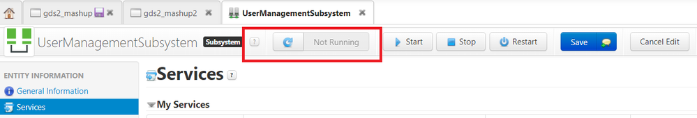

  I am facing an issue in session parameter , as am getting it empty. I need to pass my mashup name as parameter to another mashup. I am getting seeion as emty as shown belowempty_session.png
and when i looked into Subsytem--> usermanagementsubsytem--> it is not running. see the below screenshot.
Please help me to solve this issue? Reply as soon as possible,

Add a parameter in "GlobalSessionProperties" thingshape. You can able see added parameter here.
