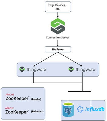

With the help of @Jimwang and after lots of documentation searches on the PTC Knowledge base, concluded below.

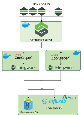

Hi @Jimwang,
I have made the below flow, but I am unsure If I need Zoo Keepers or not...
pshashipreetham_1-1698381771422.pngThanks,
Shashi Preetham,
+91 8099838001 | shashi@psptechhub.com,
PSPTechHub  ||  World of PTC Thingworx  ||  LinkedIn
@pshashipreetham
per the diagram, it is my understanding that you are trying to setup a Thingworx High Availability Clustering, in such case, it is mandatory to have zookeeper in the cluster.
For detailed information, you can refer to Thingworx High Availablity in help center
