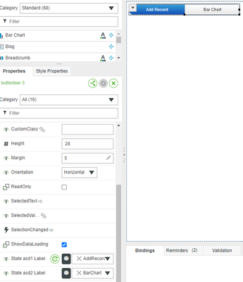

I only found the static solution to set a label in the widget (see bottom left):
Inspecting the .js code of the widget it does not look there is another possibility: It checks if the widget "property" exists (we can set in builder), if not it takes the displayName:
Hello @nmutter,
Ah... I had completely missed the widget properties for the different state labels!
It is perhaps not exactly what I wanted to be able to do, as it will require us to manually change each mashup where the state is used.
But it is close enough to fix my issue.
Thanks!
