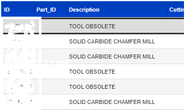

I need to display the tools in the info table that is selected in the dropdown list  i,e if Mill is selected from dropdown the respective tool details should be show in the table.
Hi @Keerthi101.
Would it work for you to retrieve the details from the external database when a tool is selected from the dropdown?  If so, you can create a service to retrieve the details and bind that service to a grid or some other appropriate widget.  This will eliminate the need to store the same information in two places and it ensures that you're always pulling current information.
How to populate your infotable?  I assume the external system would be the system of record.  Is that correct?
