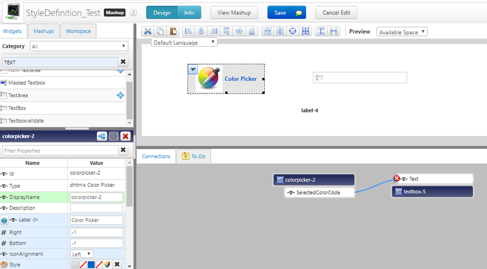

1) chart.png1.png2.pngI saw a thread in community and tried to create style definition using script and when I run it, it doesnt show any output. What should be the base type to create a style definition?

2)  I am using a colour picker widget downloaded from market place where the selected colour appears like a code. How can I bind the output of the selected colour from colour picker to the style definition?

I believe the goal here is to make some kind of theming?
If so, you can do it with CSS and TWX 8.3 and above.
To generate that CSS, a some of the widgets have been created by me in CSS Widget Configurator. With this you can basically bypass StyleDefinitions.
With this you can have different CSS files locally and append them to the header with jQuery based on some user preference with the expression widget.
Let me know if this helps in any way :)
2 REPLIES 2
Could you please clarify what you mean by base type? You don't need to set anything to output, if that's what you are asking. The result still be listed in the style definitions.
As for the marketplace extension, I believe it's not supported anymore.
