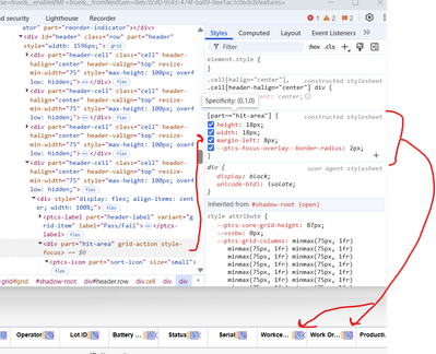

The new grid has a sorting icon that takes up a lot of space when space is limited. I am trying to style this to remove this 8px margin. Any idea on how to remove this?
Alternatively, is there a way to remove the icon completely out of the box and just have the column clickable similar to the old widget?

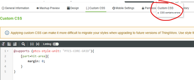

Hi @JO_9930585,
Please try the following custom CSS. Ensure to verify if custom CSS is still working after you upgrade your ThingWorx.
@supports (ptcs-style-unit: "PTCS-CORE-GRID"){
    [part=hit-area]{
        margin: 0;

Thingwors is saying this is invalid css and will not let me save this..
Hi @JO_9930585,
Forgot to mention that please turn off the Linting (the toggle button) and you should be able to save the mashup successfully.
Tony
JO_9930585
(To:TonyZhang)
This worked. Thanks! I will accept it as a solution.
Would you mind explaining this part though? I don't see this in the CSS explicitly.
Hi @JO_9930585,
This is the new way of styling web component widgets introduced since ThingWorx 9.3.4.
PTCS-CORE-GRID is a web component and is the shadow host of the element (part=hit-area) that you want to style in this case.
Please check the ThingWorx Help Center - Applying Custom CSS Styling to Web Component Widgets
