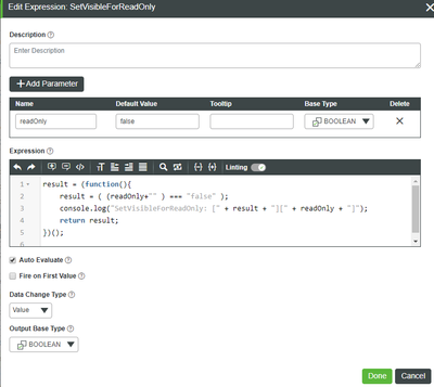

Hi ,

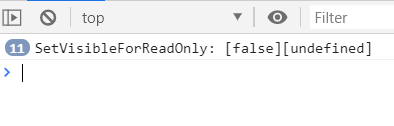

I set  default value to false for a Boolean type parameter of Expression.  By doing so , I expect never should have undefined received, however ,  I still get undefined value for the initialization.  please check the screenshot below.

Hello Sean,
Thank you for reaching out on the ThingWorx Developers Community.
Firstly, I do apologize for the delay in reply.
Based on the details provided here this does look to be a defect and as such my recommendation would be to submit a case with Technical Support via the PTC Support Portal. We can then proceed to test and submit this to R&D if applicable.
