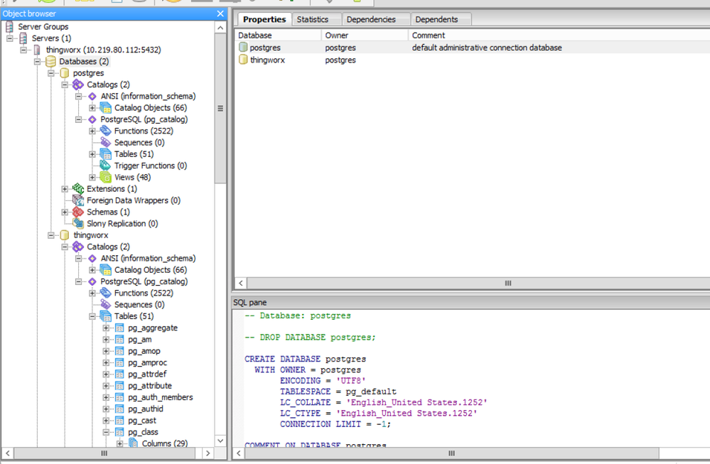

I'm having difficulty with this. Ive made a few unsuccessful attempts to use that syntax you've provided but can't determine the "JDBC Connection URL" syntax.
A few follow-up questions: They may sound off since I'm new to this.
1. Does it matter that I've installed ThingWorx with PostGreSQL? Would that change the information?
2. Here is a screen shot of my postgresql in case it helps:postgres_screenshot.PNG
3. I'm assuming the original location mentioned by the training course had a database called thingworxtrainingsample and that information doesn't match my current system and is no longer useful?

Hi @domderose
1. from the ThingWorx training material -- it comes an example to work with MySQL
- so you have to install MySQL database to your machine
- provide configuration on entity on composer to connect to Database MySQL ( provide mySQL jdbc drivers, URL's to configuration tab as mentioned in doc of training materials)
- also place the specific mysqljdbc.jar to tomcat installation lib folder and restart the tomcat
- see that isConnected value is turn to true -- on entity over composer from where you are executing the service
further there is no difference in using the postgresql, Ms SQL server, MySQL database - these are only the different databases
ThingWorx provides default already inbuilt persistence providers like H2, postgresql , MS SQL server
you can download any specific version of ThingWorx from PTC downloads
for postgresql, MS SQL server -- ptc installation document provides scripts to setup the database and schema
for H2 - there are no such scripts-- it comes with as inbuilt feature in ThingWorx
2. from your screenshot placed for postgres database thingworx setup - i think the database setup is not done completely. ideally the number of tables should be 58 but in your case they are 51
it seems something wrong with executing the scripts completely
On this you first cleanup the database using clean up scripts which comes with PTC software downloads( install folder)
then again re run the database and schema scripts as mentioned in installation documents
3. the training course had a database called thingworxtrainingsample -- this is ready to use database as mentioned in training material. once setup for MySQL is done followed by imports--thingworxtrainingsample database is observed at DB side
