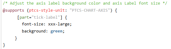

Hello @krishnakomal123 .
I asked one of the Subject Matter Experts and they were able to provide direction.
Please try the following and let me know if it meets your needs.
I have placed the same information in the Article - CS439465 - ThingWorx Web Components Customization with CSS
Let me know if you have any problems.
