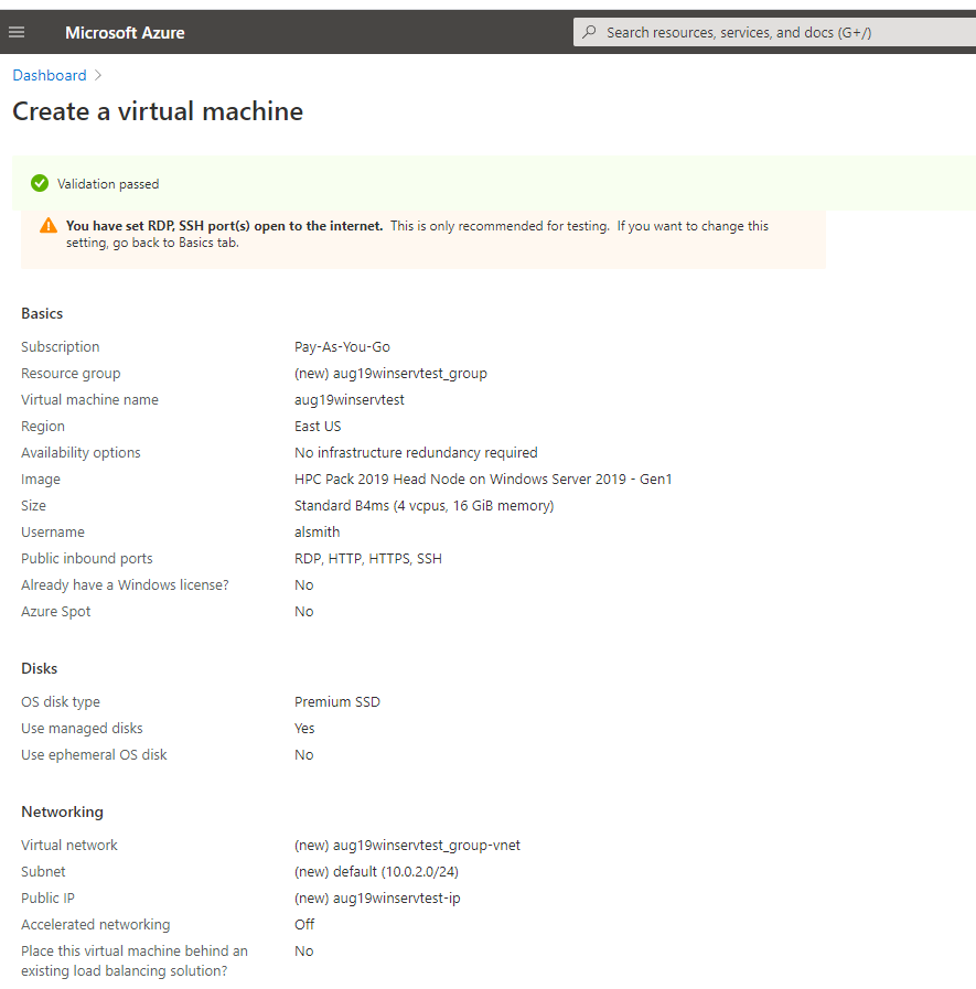

I just confirmed that installing ThingWorx trial works on a Windows Server 2019 Datacenter instance running in Azure:
I created a 4 CPU, 16GB server running the latest available version of Windows Server 2019:
After the server was created in Azure:

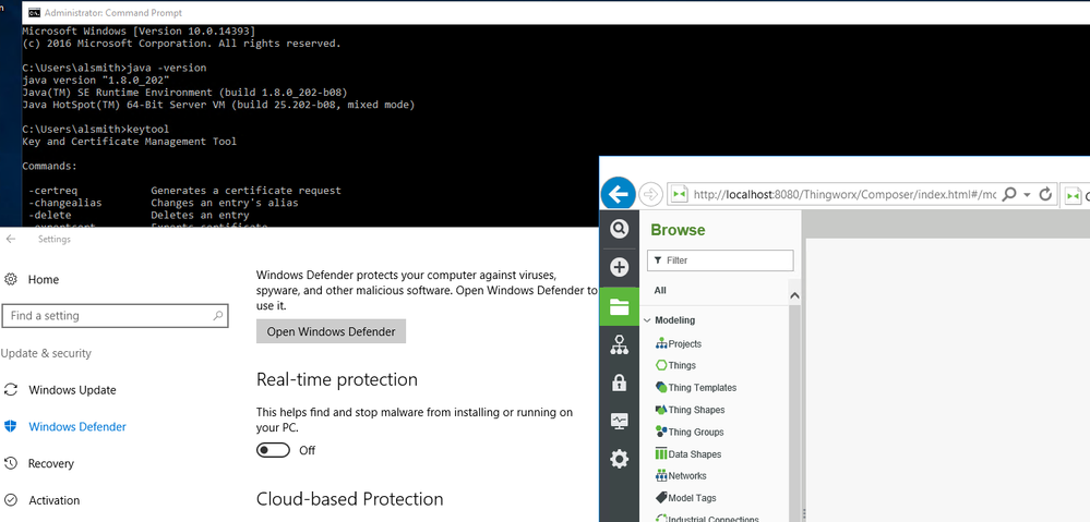

1. I installed 64 bit Java 1.8.0_261 downloaded from Oracle
2. I changed the PATH variable from the default way that Oracle sets it, and added the Java /bin directory to the PATH. You can confirm the PATH is correct by running `keytool` and `java -version` from a command prompt. Confirm that you have 64 bit Java installed.
3. I downloaded and unzipped the ThingWorx installer from the ThingWorx Developer Portal.
4. I turned off Windows Defender anti-virus software:

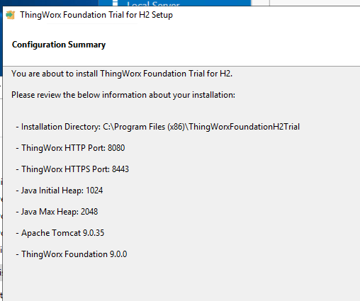

5. I ran the ThingWorx installer as Administrator using these configurations:

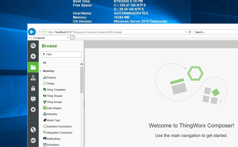

When installation completed, I browsed to `http://localhost:8080/Thingworx` and entered `Administrator` and the password I had entered during the install process.

The last line of the log file indicates that Java keytool was unable to run.
1. Anti-virus software could be preventing keytool from running.
2. The user running the installer may not have sufficient privileges to modify files or write to the directory.
3. The location of the Java application ‘keytool’ is not on your PATH.
Please confirm step 5 of this guide gives the expected result:

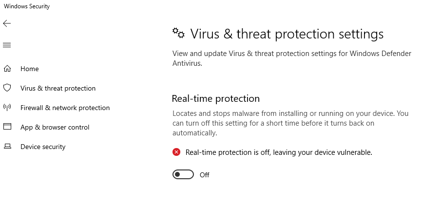

Ok great, I went through the list:
I attached the Windows security screen... you can see that all firewalls are disabled and that there is no antivirus line because Windows Defender has been completely uninstalled and there is nothing else on that server.
Also the keytool works fine if I start it from the command prompt.
