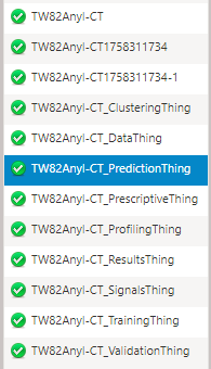

Just out of curiosity, when I look at the connected remote things there is a PredictionThing connected by default as in the screenshot:
And in the default standalone_jars file on the analytics server, you already have the predictive-standalone.yml file as well as a jar file called predictive-ms.jar.

cmorfin
(To:jbester)
Hi
The PredictionThing that you see is one of the service things created by ThingWorx Analytics Server.
ThingPredictor is an independent standalone scoring service.
It actually does use a similar engine but is packaged in a standalone way to allow  access to the scoring functionality without the need of a full ThingWorx Analytics Server.
Note that this is true as of release 8.2. It is likely to change in future release where we probably will have only one scoring agent.
