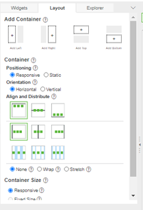

There are changes in how layout is handled. Have you looked at the Layout tab?
With the layout tab you can create additional containers. You can set the positioning on the items in the container.
Peter
