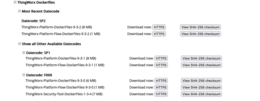

I can't see these files in the portal. Are they availble elsewhere ?
Actually they are there but not against the SP, in case others are also looking
@MP_9480406 Thank you for reminding me this. Indeed, if some installation files are not updated in subsequent SP releases, they will not show up there, and you must search them in older releases.
