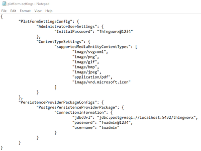

My first time to install Thingworx 9.3 on Window server 2022 and I followed the manual installation in Help Center page.
The step -> To launch ThingWorx, go to "http://localhost:8080/Thingworx" in a Web browser.
It shows screen for username and password.
I try using username: Administrator
password: <same value of InitialPassword of platform-settings.json file>  (I used Th!ngworx@1234)
but still cannot login and try to check the log into folder ThingworxStorage\logs\SecurityLog.txt
2023-01-16 00:34:22.594+0700 [L: WARN] [O: S.c.t.s.a.AuthenticationUtilities] [I: ] [U: ???] [S: ] [P: ] [T: http-nio-8080-exec-2] Authentication FAILED for [user = Administrator] using [directory service = ThingWorxDirectoryService] : Invalid Password
2023-01-16 00:34:22.594+0700 [L: WARN] [O: S.c.t.s.a.AuthenticationUtilities] [I: ] [U: ???] [S: ] [P: ] [T: http-nio-8080-exec-2] Authentication failed for [user = Administrator]. Please make sure the credentials are correct.
How to solve it? please,
Thank you.

How many times did you try to login? After a preset number of attempts, the user is locked out for 15 minutes. Only after that time it will be unlocked and allow you to try to login again.The biggest suspicion I have is the fact the password you used for the Administrator is not the one in the config file.
Either the copy paste did not work, so paste it in a word document, verify it's the correct one, then copy again and it should work.
