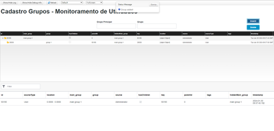

I created a Data Table that is populating a grid, but when I insert an especific item in the Data Table the grid doesn't show it, despite the item have been created in the Data Table. After I reload the page the item is finally shown,  and now I can create the items normally, and they gonna be shown in the page normally after the The Service Invoke Complete os the service insert.
I don't know why the first insert don't query in the page.

I created other service to query just to test something, but the result is the same. Note that I am binding the output in a Grid and a TreeGridAdvanced, and in the TreeGridAdvanced worked fine. Looks like a bug in the Grid.

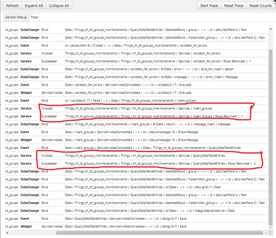

Could you please check if the query service is executed after Insert Service in the browser developer tool?

Bind service invoke complete event of insert to getGridData service, and check all other bindings are correct.

Think I did it right, I posted some photos of my bidings in Velkumar's Reply, but I think is a Grid bug because the services worked fine in a TreeGridAdvanced.
