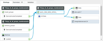

I created other service to query just to test something, but the result is the same. Note that I am binding the output in a Grid and a TreeGridAdvanced, and in the TreeGridAdvanced worked fine. Looks like a bug in the Grid.
Hi @GABRYEL25770
Mashup Bindings looks good.
Could you please check if the query service is executed after Insert Service in the browser developer tool?
Also please share the Data Table Processing Subsystem stats
/VR

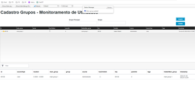

ok, I saw the  Query service is running after the insert and is returning 2 rows, but is showing just one.
Look this examples.
When I add a Main Group it displays in both Grids...
But after insert a Group it displays only in the TreeGridAdvanced.
After the first reload the Group 1 is shown in both Grids, and now the software works fine, I can insert whats I want and it'll be displayed instantly in the page.
jakhtar
(To:GABRYEL25770)
Bind service invoke complete event of insert to getGridData service, and check all other bindings are correct.

Think I did it right, I posted some photos of my bidings in Velkumar's Reply, but I think is a Grid bug because the services worked fine in a TreeGridAdvanced.
jakhtar
(To:GABRYEL25770)
Yes, your binding was correct, you may also try toggling CookiePersistence property, sometimes it does help.
