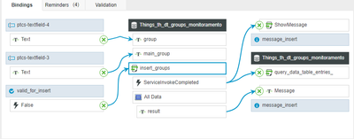

I created other service to query just to test something, but the result is the same. Note that I am binding the output in a Grid and a TreeGridAdvanced, and in the TreeGridAdvanced worked fine. Looks like a bug in the Grid.
Mashup Bindings looks good.
Could you please check if the query service is executed after Insert Service in the browser developer tool?

Bind service invoke complete event of insert to getGridData service, and check all other bindings are correct.
Think I did it right, I posted some photos of my bidings in Velkumar's Reply, but I think is a Grid bug because the services worked fine in a TreeGridAdvanced.
Yes, your binding was correct, you may also try toggling CookiePersistence property, sometimes it does help.
