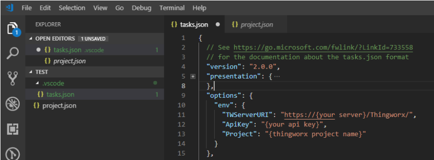

mkdir TEST
2. Start Visual Studio Code:
cd TEST
code .
task configurationtask configuration

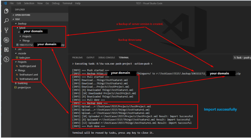

3. Pull the project from server: run task ”pull-project
pull-projectpull-project
4. Push the project to a server: run
task ”push-project
push-projectpush-project

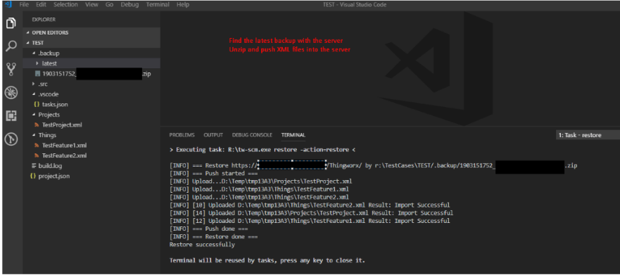

5. Restore the server by the latest backup: run task “restore”
restorerestore

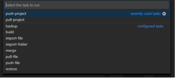

6. Task List
task-listtask-list

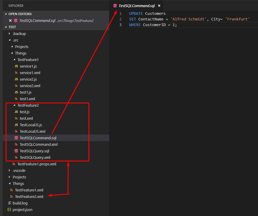

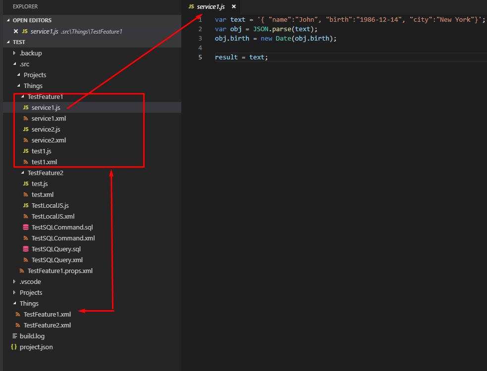

7. Editable source code in a XML file is extracted to individual files in .src folder
Javascript related serviceJavascript related serviceSQL related serviceSQL related service
