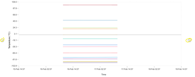

I'm facing an issue in the Timeseries chart scrolling for Zoomed-in data.
Have created a Left/Right scroll button to adjust the X-axis date range to perform a scroll to left or right direction.
I have done a logic like to set the XAxisMaximum & XAxisMinimum values binding to adjust the graph X-axis range.
- Without zooming the graph scroll is working as expected.
- But the problem is when I do a Zoomed-in for a specific point set and then try to scroll left or right. The graph is not populated as expected. Because I'm unable to find an option to read the date range min/max for a zoomed-in point set.
TimeSeries Chart View
1. Above image highlighted two arrow buttons to use to perform the scrolling.
Scroll logic is working when it is in normal graph view.

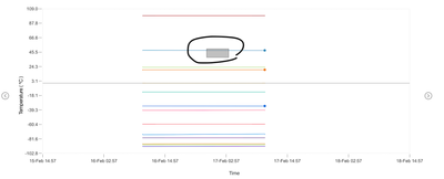

2. Below image used to zooming for a specific point set.

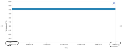

Zoomed-In View:
If we do the zooming for a specific point set and try to scroll the graph.
How do we read/get the start(XAxisMinimum)  and end (XAxisMaximum) date value for zoomed-in. I was not able to find any properties or event to get the min/max values for zoomed-in graph.
Can anyone help me on this.

Hi @MM_10109894.
The XAxisMinimum/XAxisMaximum is a one-way binding so you won't be able to pass those values back out.  However, you could develop a widget to perform the functionality you need.
Another option would be to submit an enhancement request on the ThingWorx Ideas board.  This will allow others to vote for it increasing the chance that it will be considered for a future release.

Scenario 2:
User Action : If the user wants to see a specific point set. They will select the point set range to zooming in.
Graph will populate like 01-03-2022 01:02:00 && XAxisMiaximum = 01-03-2022 01:05:00
In this scenario i need to pass the min as "01-03-2022 01:02:00" and Max as "01-03-2022 01:05:00" to find the previous or next dataset point set to populate a chart.
Scroll logic  not working as expected.
2. What are you trying to do with those values?
I'm trying to perform scroll logic for the zoomed-in graph. If i get the min & max of Xaxis. My logic will fetch the next available point set.
Problem Statement:
The problem is  I'm not able to get the Zoomed-in XAxisMinimum & XAxisMaximum date value for the zoomed-in position.
Can you help me how can we  get/read the highlighted XAxis Min & Max value.  Is there any properties or event available to do that.
