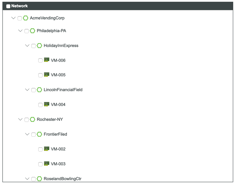

How to create the Tree chart menu in Thingworx as the above picture .
Last week ,I found the a exercise in the TW developer website for this one  .
But Unfortunately, TW developer website was update last weekend and this exercise is disappear .
Do you have any tutorial or document or the links for this one ?
In order to create something like this, you'll need to create a Network and create a service that has JavaScript similar to the below functionality.
Example Network Structure:
Example Javascript:
Example Javascript:
