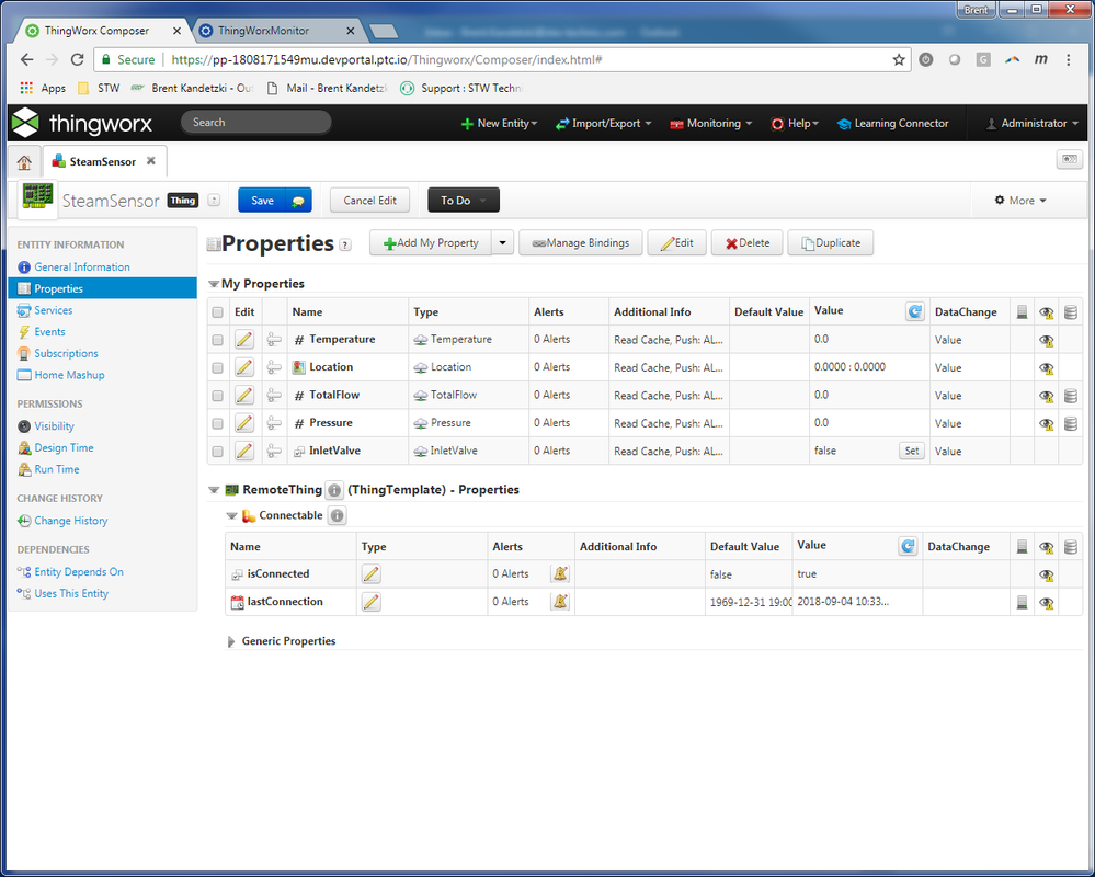

I'm working with the SteamSensor Example included with the C-SDK. I have the client built, and I've created a thing with the same name. I know that the SteamSensor thing is connecting, as I see the isConnected and lastConnection properties change when the client runs. I've bound a few of the properties to the Thing, but I'm not seeing any data values, and I'm seeing errors from the client.
Here is a sample of the client output.

[ERROR] 2018-09-04 10:09:33,938: twMessaging::handleMessage: Response ID 104 has code 160: Entity SteamSensor does not exist or is not yet associated with a Thing

Hi @brentzki your RemoteThing SteamThing seems to be connected, if i check the isConnected value which is true and the date/time stamp for the last connection seems to 2018-09-04 10:33.. which is later than the logs you have pasted which are from 10:09:33
So to me it looks like the errors are from the time may be when the thing didn't exist? Do you not see any values after you refresh with the button shown in the Value column for the properties?
How does the Remote / Unbound monitoring looks like for the SteamSensor entity in the Monitoring section?
