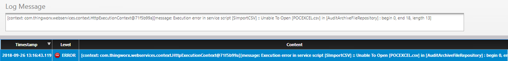

So, I'm trying to read a CSV file (function ReadCSVFile) and save it in a InfoTable. I have downloaded the CSV Parser Extension and have boiled down to the bare minimum and have not been able to get it to work. When I launch the service, the following error appears:
Error executing service SImportCSV. Message :: Unable To Open [*******] in [********] : begin 0, end 18, length 13 - See Script Error Log for more details.
What could be the problem?

What's in the  Script Error Log ?
Luistec
(To:zyuan1)
The same Log Message.

I found the error. The date type records were not correct.
Incorrect date type: 2018/9/2 -------- Correct date type: 2018/09/02
