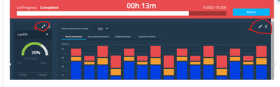

Hi Team,
as i shown in below image , trying to create Expand and collapse button on container,
but in second container(Chart) button i need at top right above the chart. Is it possible in Thingworx 9.3?
pls suggest how we can design this.
VS

Thanks for the reply, I followed same article but still  can't achieve as i want . pls see below use case
I have metric and Graph panel , if I expand metric, two more metrics should see (Total 3 are there , by default only 1 can see without expand). It means can we adjust Collapse size upto two metric?

No. this is just Expand /Collapse. I need to change/reduce container width when collapse.
I believe, that's not possible to change size of container in runtime. May be, you can do workaround with Tab.
