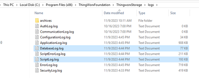

To download Thingworx Scriptlog.log file and DatabaseLog.log from repository, kindly share me the URL.
The below attempts failed to download the ThingWorx repository files
http://localhost/Thingworx/FileScriptLogs/logs/ScriptLog.log
http://localhost/Thingworx/logs/ScriptLog.log
