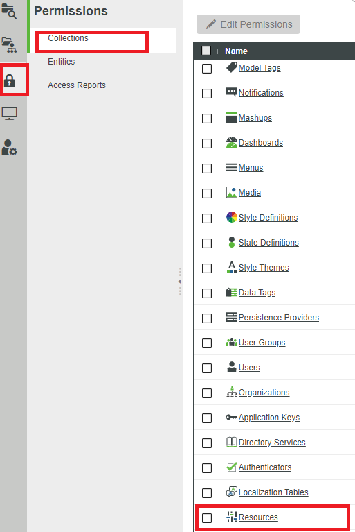

Hi @ashishiot
You need to collective permissions to resource. PFB PNG for reference

@Velkumar   The runtime and Designtime permissions are already in place for user Ashish. Still Script fucntions are not visible.
@ashishiot  Did you also assigned visibility permission to the user ?

visibilty is only for Organization/project right.? Anyway that is also there. For User, Design and Run time permissions are given. These function are wrapped along as Javascript built in functions and are not from standard ES5. i am not able to find these services anywhere even in Administrator User.
