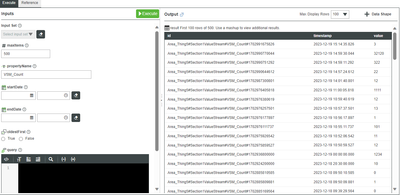

I am looking to update multiple properties by making use of the service UpdatePropertyValues but I don't seem to be getting it right.
I am using python to post my data and I get a 200 response back but the values are not actually updating when I use the service QueryNumberPropertyHistory.

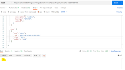

Created thing "Demo" and property "speed" (INTEGER)
http://localhost:8080/Thingworx/Things/Demo/Services/UpdatePropertyValues?ts=1702991337784
1702991337784 - Refers UNIX Timestamp
Following payload data will be used to update speed proprty to 10.

Hi @Yedukrishnan Yes the property is set to persist and logged.
I am able to see the property history after using the following API:
Payload: {"Item_count": 12}
Using the put method.
What other information would you need to assist? I am very new to thingworx so I am unsure at this point.
So when I QueryNumberHistory, I do see a history of values but when I use the :UpdatePropertyValues service, i do not see the values in the value stream.

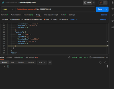

Hi @Sathishkumar_C thank you for your response.
I have done the following:
curl --location 'http://localhost/Thingworx/Things/Area_Thing5/Services/UpdatePropertyValues?ts=1702937532012' \

My response is blank:
And still nothing in the value stream.
Hoping you can help further
Response should be 1.
  • Are you able to see value in property?
  • Other options also you can try.... Create custom service with 1 input... and update from the custom server.
It works fine, however the response is still nothing.
Not sure if it is the thingworx version that I am using.
NiKlaus
(To:NiKlaus)
Hi @Sathishkumar_C it seems to be working on all of my other properties except for one. I am not sure why the one propery is not updateding. I duplicated and deleted the old one and it is working fine.
