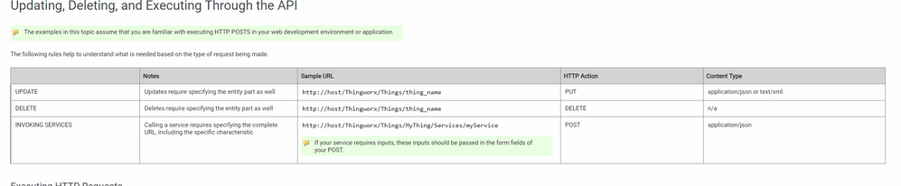

I think there is no way to execute the service of thingworx with GET request as you can see in the screenshot below. I just want to send the datatable entries to the other platform but now i have an idea that i will set the property of thing as an infotable and fill the data in it and then with get request i am able to fetch it. or do you have some other solution for me? I want entries to go into another platform. for now i am thinking to fill the data into the VALUE of the PROPERTY programmatically and then the people can get our data with get request.
I am still unclear what you want to do.
But from the article you can execute a thingworx service with a GET call if you send it with the method=POST parameter. It is not so clear maybe from the table but the first column is bascially the request type which it should be, but with the 'workaround' in the column next to it you can achieve what you want:
MA8731174
(To:nmutter)
I want to execute the thingworx service with GET Request which is not possible at all!! I dont want to use POST request method because my other team where they want our thingworx data that platform do not use this post request. i hope u understand me now.
Ok. But this is what we are talking about. You can do it like that:
GET https://<HOST>/Thingworx/Things/Quality.Main.Controller/Services/LiveDataAPI?method=POST
When in the PlatformSubsystem you did enable the "Allow Request Method"
