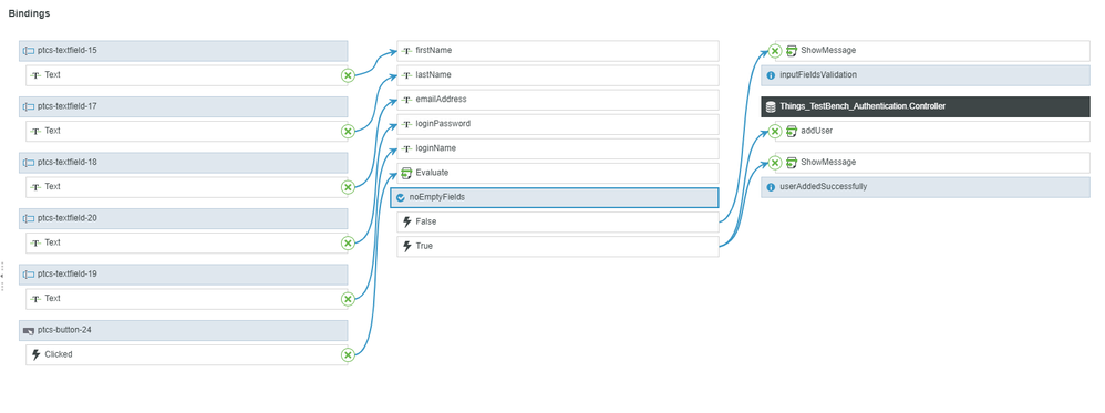

I have used a validor to check textfields text are empty or not and if not empty then i am executing a service because validator will return TRUE otherwise i show message with status message FUNCTION to show that please enter the text into fields but it is not working. if i normally write output= true or false then only it works. can anyone please guide me in this regard. I have put a screenshot of bindings and my parameters also please have a look into it. I am using Thingworx 9.3

What browser are you using? Because I stumbled upon a strange behavior a few years ago:
Output = false;
if (inputStr) {
Output = true;
This snippet will always return "true" if you are using a Chrome-based Browser; no matter what the "inputStr" is. When executing the same expression in Firefox or IE, it will work fine.
I have contacted the PTC support about this. The answer was, that this was not a Thingworx bug since expression are executing by the browsers JS engine, therefore the results may differ.
So you have to use the good ol' if-else pattern:
if (inputStr) {
Output = true;
} else {
Output = false;
One additional hint:
If you checking strings for falsy values, it is sufficient to use "if (!myString)" as check. So you don't need the check for undefined/null/"". Be careful when using it for numeric data types since 0 (zero) is also a falsy value.

Put some console.log into the isValid method with input and the result. I guess this should help you finding out if it behaves like you expect.
You can also reference the "Use truthy and falsy cases" in Best Practices for Coding in JavaScript which could simplify your isValid method to
return !!param;
as JS evaluates a lot of cases automatically to false (like undefined, null, "", ...).
Also I'm not sure if maybe the 'let Output = false' is an issue in the 1st line. Maybe try with 'Output =false' instead - as the 'let' keyword defines the variable only for the current scope - so it may not exist anymore in the internal TWX logic.
