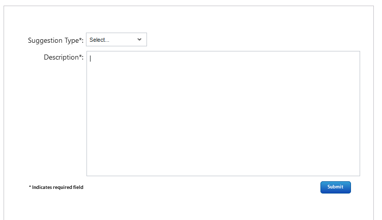

I'm unable to get a validator for dropdown widget to work.  The validator is supposed to check if a selection was made from a dropdown widget.  I've tried the following in the validator but it still goes through.  How can I get this validator to work?  The validator input is bound to Selected Row of the service that populates the dropdown.
(Type !== "") && (Type !== null);
//(Type == "New Functionality") || (Type == "Bug Report") || (Type == "Other");

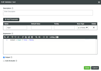

If you are still having issues with this, and for anyone finding this post, you could try using the actual selected value in your dropdown instead.
Either by using the selected row from your service service:
But using the actual variable of the row instead of the infotable.
Or use the selected text of the dropdown widget:
Drag one or the other to your validator widget and you can write the validator like this:
output = Input ? true : false;
This should give you what you want.
It will return true if "Input" has a value and false if there is no value, like null, undefined, empty string etc.
