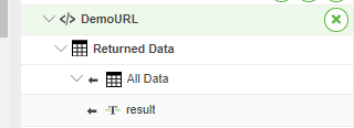

We are trying to use URL property of a web frame dynamically. We have binded the URL property with our service output. But the frame doesn't open/load the URL.
If I keep the URL property as hardcoded string instead of binding it to service opens up the URL.

HI @Vimal_Rawat ,
As per your image of framebinding, You have binded the service Result - Output from SelectedRows to WebFrame - URL Property.
Can you please try to change with All Data > Result - Output and check it once?

Changing the binding from selectedRows to results did work.
But i am not clear when to use result and when to use selectedRows. i had an impression that i can bind either of them and it would be same result.
The regular "All Data" binding is used to populate data from a service into a widget before anything has been selected.
SelectedRows binding is used when you have bound the data from a service to a widget like a dropdown or grid.
Then when you select something in those widgets, you will end up with data in the services "SelectedRows" binding.
Hope this clarifies the differences.
