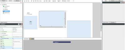

I was wondering regarding web frames. I have attached a picture of a static mashup and a web frame.
There is a grey border around the web frame which in this case shows a .jpg of the google logo. This is also the situation in responsive mashup with layouts.
My question is. Is it possible to get rid of the grey border? - If not, where do I propose a change/improvement?

Hi @jonasf.
We created myWebframeBorderClass using the custom CSS editor and applied this class to the widget:
.myWebframeBorderClass .widget-webframe-container {
    border: 5px solid #9a9fa6;
Give this a try and let us know if you still have questions.

Hi @jonasf.
Is your screenshot from a laptop/desktop browser?  What version of ThingWorx are you running?  What selections did you make when creating the mashup?
Could you please export the mashup and post it here?

Currently using ThingWorx 8.4.2-b2151 and the screenshot is taken on a desktop browser in the view mashup window. The settings are found below.
As mentioned earlier the mashup is a static frame but the same behaviour exists with a responsive mashup where layouts are used.

Hi @jonasf.
You can use the Custom CSS editor for designing the border appropriate for your application.  Note there is also a tutorial available.
The border for the webframe widget is 1 px by default.  You should be able to change this to 0 or change the color.
If you run into issues, please provide your CSS for our review.

After reviewing the tutorials I was able to use the Custom CSS to change the behavior/look of a button. Although after trying this on a web frame with the following code:
.widget-fieldset .widget-webframe {
    border-color: red;
    border-width: 5px;
It does not affect the web frame widget the slightest.
What is the correct syntax?

Thank you, that definitely works!
