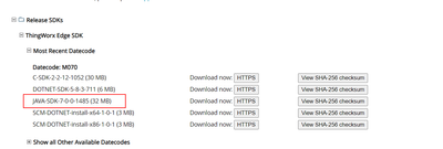

The latest version of ThingWorx Edge SDK is JAVA-SDK-7-0-0-1485 , size 32 MB.
The latest version of ThingWorx Extension SDK is ThingWorx-Extension-SDK-9-1-0, size 7M.
What's the difference between them ?  Can I regard the ThingWorx Extension SDK  as a subset of the ThingWorx Edge SDK ?
