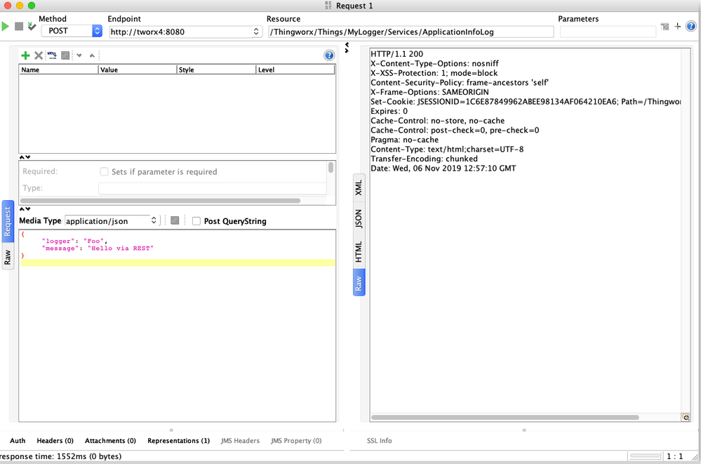

you could solve this by implementing an extension. Define your own Shape with some services. Within these services you can address your required logger.
Logger APP_LOGGER = LogUtilities.getInstance().getApplicationLogger("sublogger-name");
Logger CONFIG_LOGGER = LogUtilities.getInstance().getConfigurationLogger("sublogger-name");
Create a thing, add your shape. Now can use this thing via REST to report into specific logger.
This may help: import attached extension.
Create a thing name 'MyLogger' using shape 'IF.LoggerShape'.
Now you can try directly from Javascript:
Things['MyLogger'].ApplicationInfoLog({
logger: "Foo" /* STRING */,
message: "Hello" /* STRING */
Our via REST: you need to adjust hostname (and thing-name).
http://hostname:8080/Thingworx/Things/MyLogger/Services/ApplicationInfoLog
POST body like:
"logger"": "Foo"
"message"": "Hello via REST"

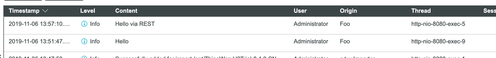

Result should be like this:
