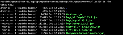

we are running Thingworx9 in docker container and it looks like that one part of Thingworx is using affected libraries.
