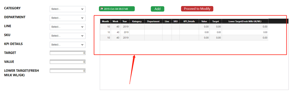

when I refresh the page, it will auto increment one more empty row in the grid widget.
how to fix this problem?

this is reference which I refresh the page.
Hi Mr. Xiao,
Actually it seems like each time your mashup is refreshed, your addEntries service is triggered once. While when you refresh the mashup, the inputs are blank, thus you're getting empty records.
2 solutions for your issue:
1. Check out how mashup refresh/ loaded event is affecting the service, stop the triggering binding, problem solved.
2. Your service need several input properties, so define some of the input to be "Required", then even if the service is trigger automatically, the service would fail, and you won't get blank records again, just some script errors.

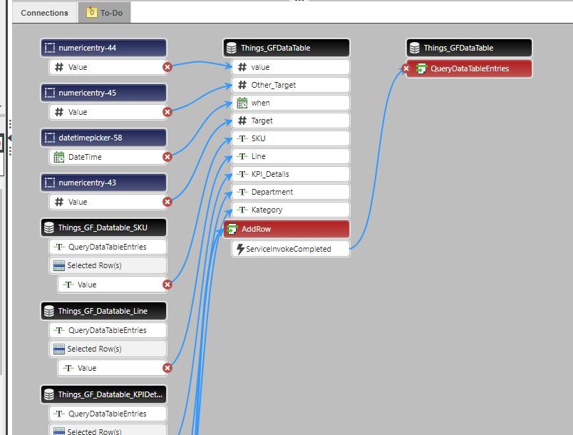

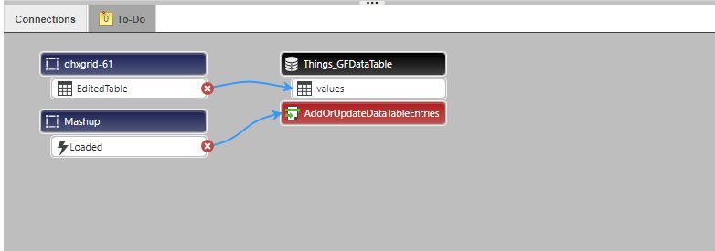

xiaoqw
(To:zyuan1)
here is my binding. Maybe here is some problem. Please help me to check it again. thank you
here is my latest code. Still have some problem.

Cancel the Mashup-loaded binding to Execute AddorUpdateDatatableEntries service, that's what I'm talking about.
Shouldn't your service be triggered by the Add button - click event?
xiaoqw
(To:zyuan1)
Yes. Sure.i bind it with ‘QueryDatatableEnrties’ and ‘Addrow’ services
But in your 1.JPG screenshot it's not. Fix it and check.
