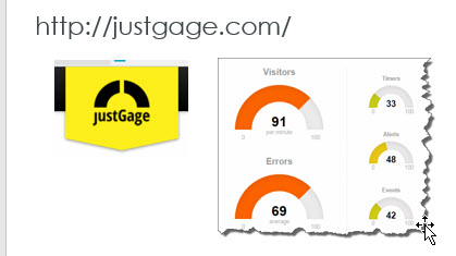

I have attached a percentage widget extension I created as an example on how to create widgets.
Also you could use the library http://justgage,com which I explored as an library example. Each of these solutions are not complete but should provide a good starting point.
