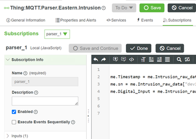

next i created a subscription to run on data change event for the Intrusion_raw_data property , here is the script:
me.Timestamp = me.Intrusion_raw_data["Timestamp"];
me.sn = me.Intrusion_raw_data["deviceId"];
me.Digital_Input = me.Intrusion_raw_data["Digital Input"];
when new data comes from the broker the Intrusion_raw_data property updates fine and get the new data and i can see it, but it looks like the subscription does not run , but when i try to change the Intrusion_raw_data manually inside the thing it self the subscription script runs fine and update the other properties without any problems,

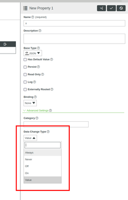

Also, check "Data change type" on your Intrusion_raw_data property -- it controls how it fires DataChange events. If it's set to "Value" (default), then your subscription will only fire when data actually changes, not every time you received something. To troubleshoot you can try setting it to "Always".
/ Constantine
can you explain more what you mean as i did enable all of these
I was referring to "Enabled" checkbox -- you have it. Also check this one, maybe try setting it to "Always" and see if it helps:

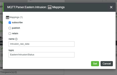

  4. Check if there's any relevant settings on the MQTT thing's Configuration (in addition to Mappings)
