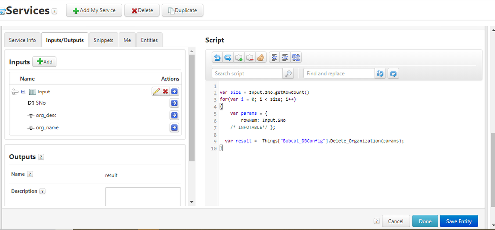

I wanted to delete multiple rows in sql database. I have given the input as infotable which has default datashape that I have binded the grid to. The grid data selected rows I am giving as input to the multi delete service infotable ip. I tried using the grid advanced but the code does not work.
The Things["Bobcat_DBConfig"].Delete_Organization(params) is the service which has sql query to delete the row (
WITH cte AS
SELECT ROW_NUMBER() OVER(ORDER BY org_id) AS Row
FROM Organization
DELETE FROM cte
WHERE Row = [[rowNum]] )
multidelete.pngHow could I resolve this?
Thanks in advance,
Shalini V.

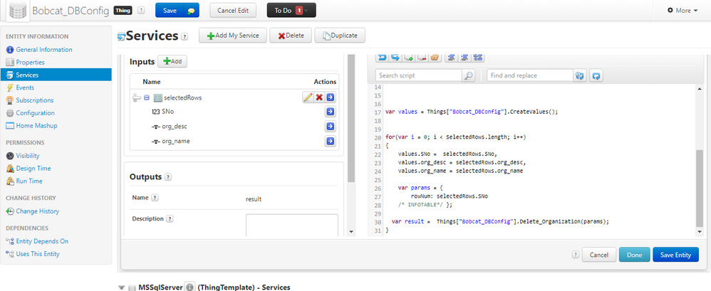

As you said I have added a loop, But still I am not able to delete multiple rows in database.
var size = Input.SNo.getRowCount()
for(var i = 0; i < size; i++)
var params = {
rowNum: Input.SNo
/* INFOTABLE*/ };
var result = Things["Bobcat_DBConfig"].Delete_Organization(params);
Could you please help me with what I am missing.connection.pngmultidelete1.png
Delete_Organization is your SQL command?
Skip the for loop first, does this script work when size =1 (run by single row)

Even when I run by single row the script doesnt work.
Input for this SQL script is one row of infotable? or separate string parameters?
Hi @zyuan1 ,
The input for this sql script is the the selected rows of the infotable of the grid data.
@svisveswaraiya  I would suggest you to create a case for it, so that TS engineers could get a closer look into the problem.  This is your customized scripts, around the edge of support scope, but since it's a simple function so hopefully we could provide some useful suggestions.
