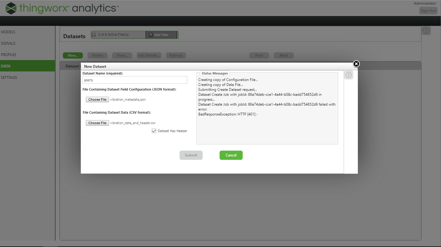

HI community ,
when i try to creat a new dataset i get this msg :
Creating copy of Configuration File...
Creating copy of Data File...
Submitting Create Dataset request...
Dataset Create Job with jobId: 52cac97b-d5f0-4e41-81b1-c4e23ced4114 in progress...
Dataset Create Job with jobId: 52cac97b-d5f0-4e41-81b1-c4e23ced4114 failed with error:
SSLException: Unrecognized SSL message, plaintext connection?
Thank you .

nsampat
(To:Nessrine)
Thank you for posting to the ThingWorx Community.
Is your connection to your ThingWorx Analytics server configured to use SSL?
This error occurs if SSL is not configured or setup correctly. If you deselect the SSL option, your data should upload.

i restart all docker containers and this time i get an other error msg :
nsampat
(To:Nessrine)
You may need to restart the docker containers again using the information in this Article. That error message indicates that some services were not started in proper order after the docker restart.
Are you using the ThingWorx Trial Edition, or just docker deployment of ThingWorx Analytics?  Can you supply what version of ThingWorx Analytics you are using?
