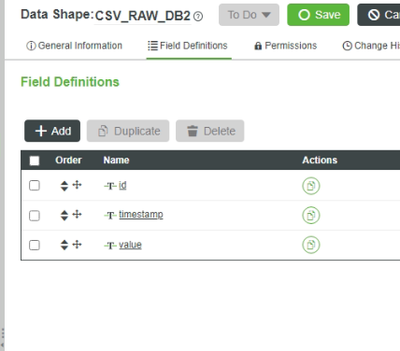

how to read csv file and then input in datashap
TW_10599876
7-Bedrock
this is my service and my datashap
this csv file
The comment in line 18 indicates you should provide the name of a datashape.
You are providing an infotable.
Instead of result_table, try to pass just the string "CSV_RAW_DB2".
Also, consider switching to a supported CSV Reader.
