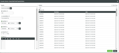

Yes this property is providing latest value. But how to get VTQ for the data other than latest value.

This is a logged property and its value updating using services. The value is of datatype of datetime. Its timestamp also we expecting to be same as its value. so that it will be easy to query using timestamp.
for example :- if the value is "2022-04-27 23:45:00.000", its timestamp also should be "2022-04-27 23:45:00.000" like a vtq property. How to achieve this?

You can force the timestamp by using the AddValueStreamProperty service. (or similar) So instead of logged, you would do a subscription to value change and then call this service to add it to the value stream with your specific VTQ.
