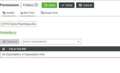

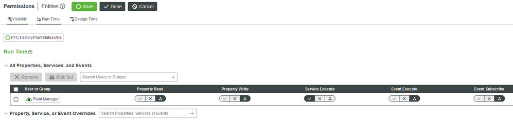

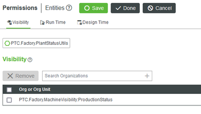

When we add the new sub-organization to visibility and runtime permissions to PTC.Factory.PlantStatusUtils thing, the member of the suborganization login to the mashup and everything works fine
Our problem is that when we restart the server and the user login to the application, we get the following permission errors:
         Entity Not Found : [PTC.Factory.PlantStatusUtils]
And when we view visibility and runtime permissions again, the tables are empty.
I attach the image files with permissions changed:
And how we view the same thing after restart the server:
