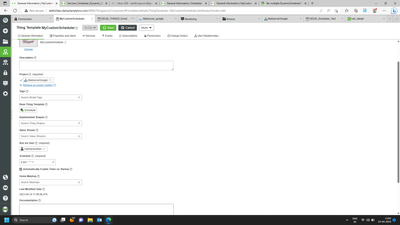

Hi @Hariharasuthan
Please follow the below steps :
Step 1: Create a new Scheduler ThingTemplate say 'MyCustomScheduler' from the default Scheduler Template
Step 2: Create a Subscription in ThingTemplate which you created in Step 1
Step 3: Subscription Event should be SchedulerEvent and put your custom email code from Project YYYY
Step 4: Now create a new scheduler Thing say 'scheduler 1' from Template 'MyCustomScheduler'
So whenever an event is triggered it will execute the code from Project YYYY
/VR

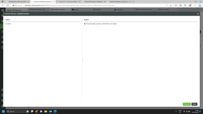

hi @Velkumar
your share steps follow and implement but some problem and some doubt came here
1.Error(
Output
 Thing [Scheduler_Dynamic_CRON139l] is not enabled)
2.doubt
MyCustomScheduler
in this thing template and also some cron value but new scheduler 1 thing in this different cron value how is it,
Hi @Hariharasuthan
1. Is Scheduler_Dynamic_CRON139l created through service? if so enable it through service after the creation.
2. You don't need to worry about CRON String in Thing Template. The event will be triggered based on individual Thing CRON string
/VR
