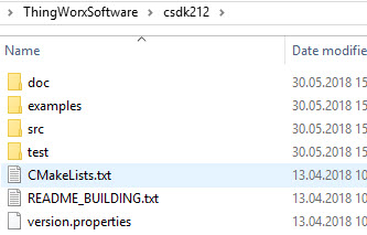

hi, i'm beginner both thingworx and C language
i download C SDK in marketplace
and download/install visual studio
after i open VsDevCmd and move SteamSensor dir
command cl main.c[changed appkey and port]
so i copy and paste header&c file in C SDK\src\...
after that dir look like following picture
but still command cl main.c appear error [but header file has changed]
how do fix it?
Has anyone experienced the same issue as me?
please help me . thanks

@mtyago I think it just mean you need to navigate to the top directory under which all the C SDK content is stored. I haven't downloaded the package from the Marketplace, but if i need to give you the example it could be something like this
You just need to navigate under this main folder > examples > SteamSensor (if you are working with steam sensor) > src , and under src/ you will find the main.c . If you are working with visual studio just CD to this location on a command prompt and then key in the start main.c . Assuming you are working on Windows platform with Visual studio, the file will automatically open in that.
BTW, I could reproduce the issue you are running into i.e. the macro issue and then not being able to locate the twCSDK.lib . I think build is failing if you are working with higher visual studio version than 2012. Therefore, I would say test with 2012 Visual Studio see if you still run into sprintf macro error.

Apologies for late reply.
I have not tried your solution, but I managed to solve the problem in a similar fashion i.e. by navigating to the top folder and running cmake, instead of running cmake in the "example/steamsensor" folder as mentioned in the document. I am not sure if it was just me who misunderstood the documentation, but its solved now.

I'm not sure what syntax you had for the cmake and on which level but it has to run from the top level as that's it finds the CMakeLists.txt require to run the cmake.
Good to know its working for you now :)
