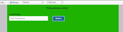

After entering thingName and click button It will showing message successfully.
I use Label widget to show message.

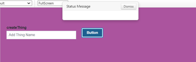

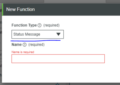

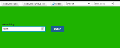

Hi @Velkumar
Here is a screenshot that what I do:-
1]                                                                                                                                                                                     2]
output:-
In above 3 screenshot-
1st one have a binding.

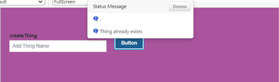

2nd one have a function -In this when we don't write anything on message box and click done .Then after viewing and clicking button the message shown in screenshot 3 as a blank.
Now I m just entering Dot [  .  ]in screenshot 2  on  message box and click done.
after viewing mashup, I m able to see notification message.
How could I do  without typing anything on message box to show message?
Hi @Pratik_Aswale
Instead of Clicked Event to show a status message. Use ServiceInvokeCompleted Event from the service to trigger/show popup message.
