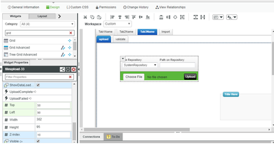

I have a Resonsive tab inside an reponsive tab. I have placed some widgets like file upload, buttons etc in side the inner tabs, but i dont get to see the widgets. While I inspect the html i find that the widgets are rendered but not visible, I have also checked the visible checkbox for each of the widgets but they are already checked.

Thanks for testing, am using version 8.4.6-b136.
@GuruPrasad1 , Can you provide more information on your test case. I created a tab set, inside a tab set and placed the file upload widget. I did not see the issue you described.
I looked at ThingWorx 8.4.8, what version are you using?
@GuruPrasad1 , Thank you for the version which you are using. I downgraded my Thingwork to 8.4.6 and I am not seeing the problem. I am attaching an export of my project. There are 2 mashup's which are a little different. Let me know if this helps.

Hi I Imported and Tested with your mashups , I found no problem am able to see all the widgets, I have to investigate more as my issue is not yet solved even yesterday the grid widget disappeared from the tab.If i a find anything I will post here.Thanks for testing
