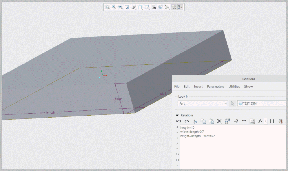

Am using creo parametric 3.0, in which is it possible to create a labelled dimension (say thickness = 10mm) a dimension and use the dimension value in the subsequent features of the model, so that i can change the thickness once and it will change in all places.
FYI, using relations is a good option, i feel like, that requires more manual work, (defining the dimensions and then giving relations).

Hello @vdevan ,
so far I understand your post , your meant in Creo Parametric some thing like this:
So let us have this simple model model with some dimensions which are driven by parameters in a relation. What should be here the relation to vuforia chalk? What do you want to manage or the change here? May be, a picuture could be very helpful the understand your issue.
Or is this more related to Vuforia Studio? In this case I think the quesiton will make for me more sense - e.g. where you want to have some parametric dependencies to change the geometry?

I fund that creating "Local Parameters"' is the answer.
Define local parameters and u can use in the model where ever you want.
