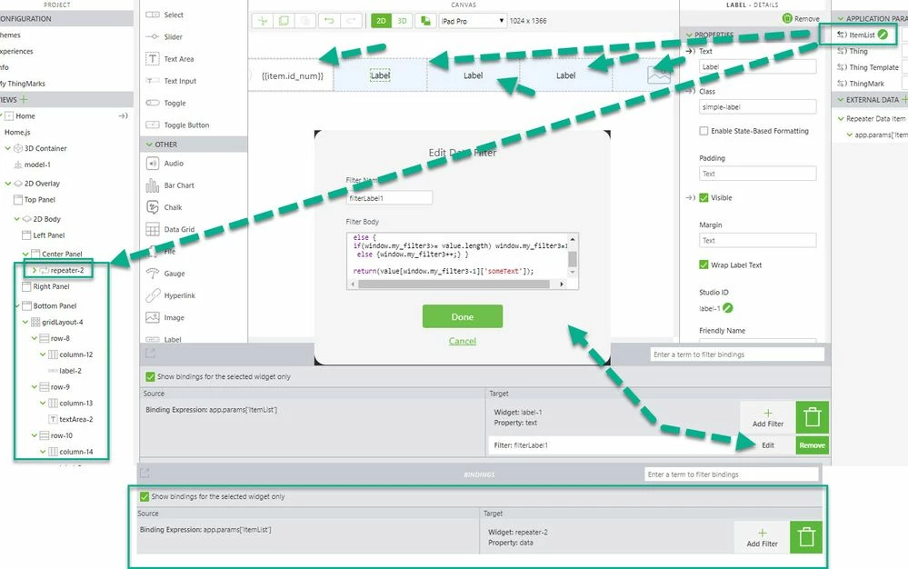

When we have the data in Studio as value of the scope variable or as global variable we can try to set it to an repeat region and create something similar as simple report:
The clue here is to set the list to an app parameter and to link then the application parameter to the repeater data and also to the different repeater elements /widgets in the row/columns of the repeater. This is not trivial because it is not intent usage of the repeater but for such simple case it will work
To be able to link the elements to the correct repeater row we need a filter. Here an example of filter function. I need a window area because this is the only way to pass variable between 2 different calls of the filter. Here an example for filter definition for a label:
//filter for the checkbox element
 //console.warn("filterLabel1");
if(!window.my_filter3) window.my_filter3=1;
 else {
 if(window.my_filter3>= value.length) window.my_filter3=1;
 else {window.my_filter3++;} }
 return(value[window.my_filter3-1]['someText']);
  and here an examle definition  for a image widget:
//filter for the Image Widget element //
 //console.warn("filterImage1");
 else {
 return('app/resources/Uploaded/'+value[window.my_filter3-1]['src']);

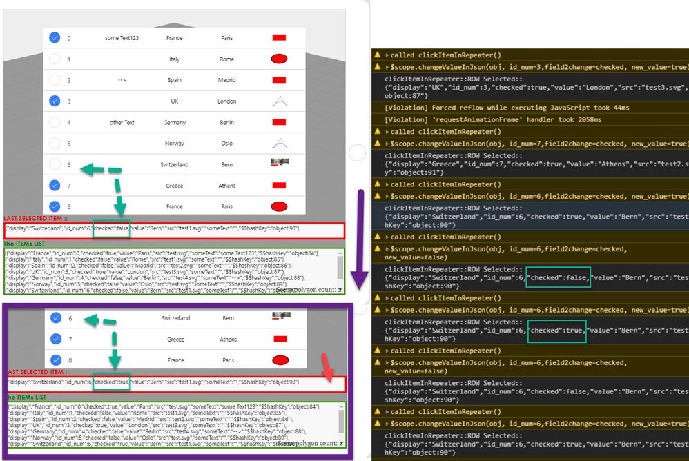

With little more work we can also implement a function which could change the value on click - e.g. a checkbox to set it to true or false and to update the list:
$scope.changeValueInJson= function (obj,id_num,field2change, new_value)
if(new_value==undefined) return;
try{if( obj[0][field2change]==undefined) return;}catch(wrong){console.error("error::"+wrong);return;}
for (var i = 0; i < obj.length; i++){
 if (obj[i]['id_num'] == id_num){
 obj[i][field2change]= new_value;}}
 $scope.app.params["ItemList"] = "";
 $scope.app.params["ItemList"] = JSON.parse(JSON.stringify(obj));//check value
 $scope.$applyAsync();
twx.app.fn.clickItemInRepeater = function(item,list,isMultiSelect)
console.warn("called clickItemInRepeater()");
 $scope.changeValueInJson(list,item.id_num,'checked', item.checked?false:true)
 console.log("clickItemInRepeater::ROW Selected:: "+JSON.stringify(item))
 $scope.setWidgetProp('textArea-2','text',JSON.stringify(item))
The callback twx.app.fn.clickItemInRepeater = function(item,list,isMultiSelect) {...  will fire when an element is clicked.
At the end we will have a list with labels where  their  content and values and number of rows is defined from a Json object- here the number of row is flexible but the number of column is fixed. Of course, we can define more columns in a row and then with filter (similar to the example) to drive their visibility.
