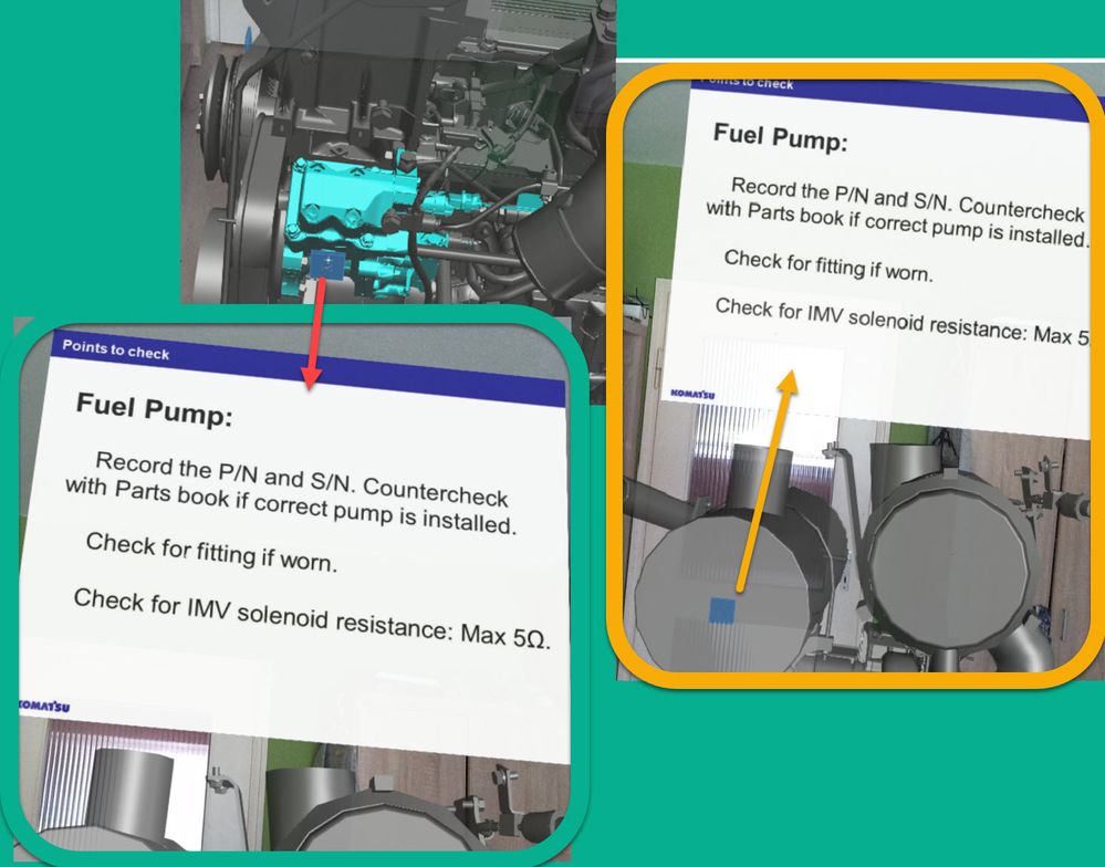

I tried to publish a 3D model with 2D Image (.jpg) in a 3DImage widget.
During Preview, i can see the 2D Image.
But when I publish it, i can't see the 2D Image at all.
Attached is the sample image when previewed.
But when viewed in the actual hololens, the 2D image is nowehere to be seen.
Is there a special js code for this one?

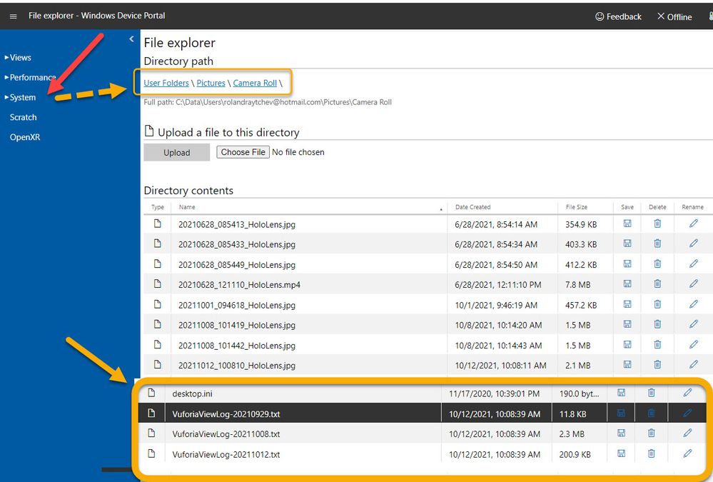

  • in the picture  above you can see the Vuforia View log file. You can start a new session and test the issue so that it is sometimes reproducible . Then you can take the VuforiaViewLog (the last 3 versions) and check there is there is an error pointing that is display issue. Respectively you can share there the log files

Is this picture what is attached the picture what you tried to used. I tested the issue for the HoloLens device with the current Studio /View app release / update this week and was not able to reproduce the problem on the Hololens. Tested the picture on both widgets – 3DImage button and 3DImage widget:
Possibly this is not the correct image file? In this case could you provide an sample image file where the issue is reproducible? Thanks
Possible reason could be the format: color settings, size (large number of pixels or large file size) . The attached file seems not to have an issue when I tested it.

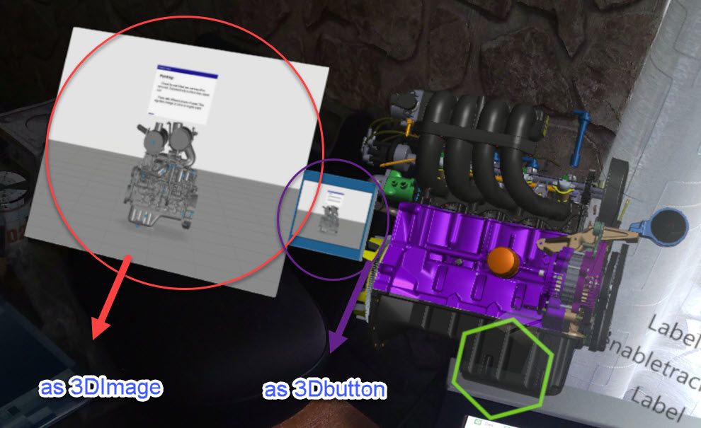

Hi @Adrian_G. ,
I tested in Studio the attached file (Slide1.JPG) in preview mode and  on my HoloLens 2 device .Both was working fine
The picture worked for 3DImage and 3Dbutton.
Because the picture was to large I scaled it by factor of 0.3. The resolution is low and possibly when it is displayed as large picture it could cause a problem.
