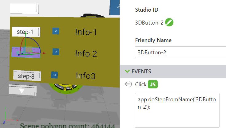

In 3D panel I have placed some buttons, checkbox and labels in order. the button should play on sequence,
if i click the first button then show the check box, label and 2nd button, similarly if i click the 2nd button the  2nd checkbox, label and 3rd button should appear and so on. How to do this sequence using js.

Hi @Rakesh_kumar_S ,

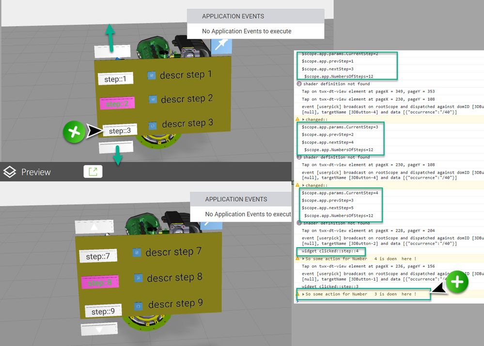

so far I understand- you want to display 3 elements which should follow the enviroment of the current selected number - so if 1,2,3 but when 9 selected then 8,9,10 . Because, to implement scrolling will be difficult in 3D (using 3D widgets) , so I think  the best approach could be to display only few elements e.g. the 3 elements as already you displayed in the pictures and to update them. So means to rename the names according to the current selected context (only with javascript) And then the call of the button click  should be something with use js switch construct -where the name (updated on runtime) is pass to select the correct option which should be run.
so I want to provide an example to the pervious post- the idea what I meant th2023-06-30_12-45-33.jpg
So you can change (some fake of scrolling) the names of the items . There a goDown and goUP button and also the data is coming form Upload folder - json file. Here in example something like this

When a button is click it will check the current text - here will extract the number from there e.g.
where the function e.g.:
$scope.app.doStepFromName=function(featName){
  let Name = $scope.app.view.Home.wdg[featName].text
  console.log("widget clicked::"+ Name);
  let num= Name.split('::')[1]
   msg_txt="So some action for Number   "+num+" is doen  here !"
   console.warn(msg_txt);
   var msg = new SpeechSynthesisUtterance(msg_txt);
   window.speechSynthesis.speak(msg);
Thaks for your reply, but i need different kind of solution, my question was,
if i clicked 1st button then show the 1st check box, 1st label & 2nd button similarly if i click the 2nd button then show the 2nd check box, 2nd label  & 3rd button. like these i want.
Great, thanks for the feedback! I think for your requirement you need just to change the provided example by little editing of the Js code. My previous post should not provide an exact solution but it will be some hint and further advice - which could be helpful  for you  to achieve the require goal. Please, let me know if you have some trouble to achieve this. What did you do and what was the problem, what was not working then?

Please check this sample project  . There is an model where is an figure with 12 step. Clicking on a button will call the step with the same number as the button. The button is named by reading of json file. Possibly this example is helpful for you. Thanks
